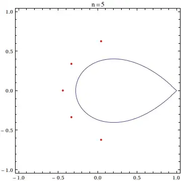

(This was supposed to be another comment to Raymond's answer, but it got too long.)
As already mentioned by Raymond, we have the relationship (using slightly different notation)
$$\Gamma(n,z)= (n-1)! \exp(-z) e_{n-1}(z)$$
where
$$e_n(z)=\sum_{k=0}^n \frac{z^k}{k!}$$
the partial sums of the Maclaurin series for $\exp(z)$, is sometimes called the exponential sum function. Though a general closed form for the roots of $e_n(z)$ is not known, the distribution of the roots of the polynomial $e_n(nz)$ in the complex plane is pretty well studied:
In particular, Gábor Szegő (1924) and Jean Dieudonné (1935) both showed that the roots of the scaled exponential sum function $e_n(nz)$ approach the portion of the curve $|z\exp(1-z)|=1$ (now often referred to as the Szegő curve) within the unit disk as $n\to\infty$. In two papers, Carpenter, Varga, and Waldvogel study the asymptotics of the zeros of $e_n(nz)$. Other papers of interest include those by Buckholtz, Newman and Rivlin (with correction), Conrey and Ghosh, Pritsker and Varga, Walker, and Zemyan. (These are the ones I've read; I'm sure there are other nice papers I've missed.)

4Thanks for the interesting links and nice illustration! I'll just add that the second paper of Varga and Carpenter 'Asymptotics for the zeros of the partial sums of e^z. II' (and many others on the same subject and the related 'partial sums of $\cos(z)\ $ and $\sin(z)\ $') are available at Varga's homepage. Cheers, – Raymond Manzoni Feb 15 '12 at 20:11
Very nice, Thanks so much for the graph and references. – K1. Feb 16 '12 at 02:00
