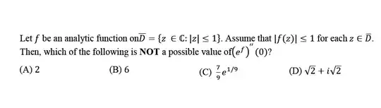

I just have answer of this question which is 6, but I don't know how to arrive at this answer. Please anyone help me solve this. How does one calculate the value of this function?

    Are you familiar with the Cauchy integral formula or the Cauchy estimate? It can be shown that $|(e^f)''(0)|$ must be less than $2e$ using this method. Let me know if you aren't sure and I can elaborate. – Braindead Jan 04 '15 at 18:39
  • @Braindead yes sir,I am familiar with Cauchy Integral Formula and with help of this I got my answer also. And thankx sir for giving time to this problem. – renu Jan 05 '15 at 08:23
Let $g(z) = \exp(f(z))$. By Cauchy's integral formula, $$ g''(0) = \frac{2!}{2\pi i} \int_{|z|=1} \frac{g(z)}{z^{3}}\,dz $$ so by the "ML"-inequality and the estimate $|g(z)| \le e$, we have $$ |g''(0)| \le \frac{2!}{2\pi} \cdot 2\pi \max_{|z|=1} \frac{g(z)}{z^{3}} \le 2e. $$
In particular, $|g''(0)| < 6$. (All the other options are smaller in modulus than $2e$.)
