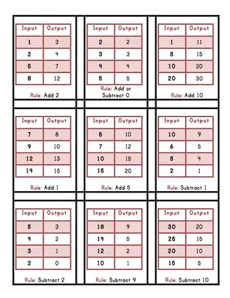

When I was in 4th and 5th grade, when we talked about functions, we talked about them in the context of function "machines" - those cute little things that took in a number and spit another one out, something like these tables:
Later, the rules would get harder. And the rules were what were called "functions". So this is what a function is, at its most fundamental level: something that takes in a number, and spits out another number according to a predetermined rule.
