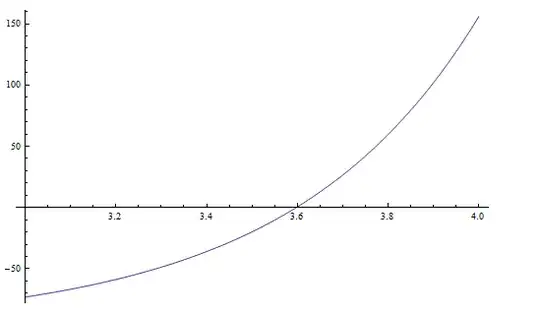

$$3^3=27\,\,\,\,\,\,\,\,\,\,\,\,\,\ 4^4=256$$ Therefore there are no integer solutions for this equation. The unique solution of this equation with $50$ decimal places can obtain using Mathematica as
$$3.5972850235404175054976522517822860691355430548866.$$
Also I plot the graph of $f(x)=x^x-100$ in $x\in[3,4].$
