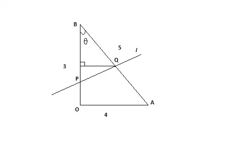

Consider triangle $\mathrm {OAB}$. Let line $l$ be the line that is supposed to divide the area and permieter in half.
Intial perimeter=$12$, initial area=$6$. Let $\angle OBA=\theta$
We get $3$ scenarios. I am discussing one here. enter image description here
$l$ intersects $AB$ in point $Q$ and $OB$ in point $P$. Let $PB$=a, $BQ$=b
$\therefore a+b=6\; (\mathrm {half\;of\;12})$
From AM-GM inequality, $a+b \ge 2\sqrt{ab} \implies ab \le9$
Area($\triangle PBQ$)= $\frac12absin\theta=3\; (\mathrm {half\; of\; 6})$
$\therefore \frac12(ab)\frac45=3 \implies ab=7.5 \lt 9$
So, this line is possible.
Check with the other two scenarios where the line intersects the other two sides. Then see whether you get any contradicting conditions on $a$ and $b$.
