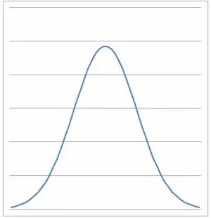

    it is kind of trigonometric function when we see its curve http://im62.gulfup.com/TRaAc7.png – Abdou Abdou Dec 25 '14 at 17:40

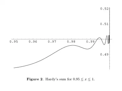

Based on a paper "Summability of alternating gap series" by J.P. Keating and J.B.Reade in year $2000$, (an online copy can be found here) , one can use Poisson summation formula to show $$ S(x) =\sum_{n=0}^\infty (-1)^n x^{2^n} = \frac12 x + \frac{2}{\log 2} \Re\sum_{n=0}^\infty\left( \frac{\Gamma(\alpha_n i)}{\lambda^{\alpha_n i}} - \sum_{k=0}^\infty \frac{(-1)^k}{k!}\frac{\lambda^k}{\alpha_n i + k} \right)$$ where $\alpha_n = \frac{(2n+1)\pi}{\log 2}$ and $x = e^{-\lambda}$.
As $x \to 1^{-}$, $S(x) - \frac12 x$ will be dominated by the first term ( the term for $\alpha_0$ ) which oscillate with amplitude
$$\frac{2}{\log 2}\left|\Gamma\left(\frac{\pi i}{\log 2}\right)\right| = \frac{2}{\sqrt{\log 2\sinh(\pi^2/\log 2)}} \sim 0.00275 $$ and periodic in $\log_2 \lambda = \frac{\log\log\frac1x}{\log 2}$ with period $2$.
Please look at the paper mentioned above for more details.

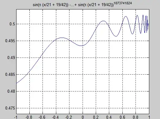

I tried to zoom in the behavior of the graph at the nearest right of x=1 using variable substitution :
x -> 1
$sin(( \frac{x-1}{a}+ \frac{1}{2}) \Pi)$ -> 1 with closer values
The graph i received looks like this :

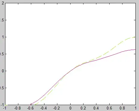

if we take deeper look (using last trigonometric magnifier) at functions $f(x)$ and $f(x_0)$ we should notice remarkable matching
$f(x)=x+\sum_k {(-1)^k x^{2^k}}$
$f(x_0)=x_0.\sum_k (\frac{1}{2^k} \sum_l ((-1)^l 2^l x_0^{2^l-1})$
syms k;syms l;x=-1:0.1:1;
for i=1 : 1000
f=@(x) sin((1/i.*(x-1)+1./2).*pi);
y=@(x,n) f(x)+symsum(((-1).^k).*(f(x).^(2.^k)),k,1,n);
yy=@(x,n) f(x).* symsum((1./2.^k).*symsum((-1).^l.*2.^l.*f(x).^(2.^l-1),l,0,k-1),k,1,n);
a=plot(x,y(x,i),'Color', [0.5, 1.0, 0.0], 'LineStyle', '--');
hold on;
b=plot(x,yy(x,i+1),'Color', [1.0, 0.0, 0.5]);
set(gca, 'XLim',[-1 1], 'YLim',[-1 2]);
grid;
pause(0.1);
delete(a);
delete(b);
grid;
end

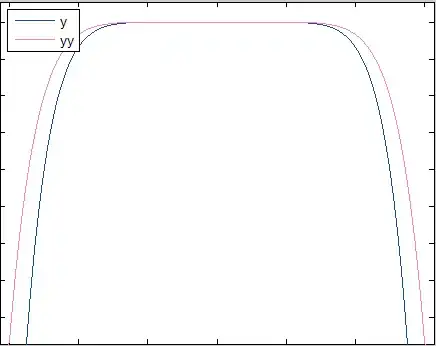

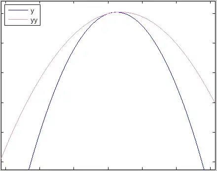

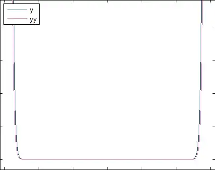

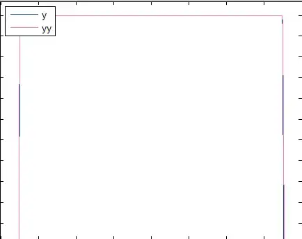

similitude of two curves:
syms x;syms k;syms l;
for i=1 : 1000
y=@(x,n) (x)+symsum(((-1)^k)*((x)^(2^k)),k,1,n);
yy=@(x,n) (x)* symsum((1/2^k)*symsum((-1)^l*2^l*(x)^(2^l-1),l,0,k-1),k,1,n);
a=ezplot(y(x,i));
set(gca, 'colororder', [1, 0.5, 0.753;0.5, 0.5, 1;1, 1, 0.753]);
hold on;
b=ezplot(yy(x,i+1));
set(gca, 'colororder', [0.1, 0.3, 0.53;0.35, 0.85, 1;1, 0.1, 0.73]);
legend({'y' 'yy'}, 'Location','NorthWest')
grid;
pause(0.1);
delete(a);
delete(b);
grid;
end
snapshots: ($f_n(x)$,$f_{n+1}(x_0)$)
n=1
n=3
n=6
n=9

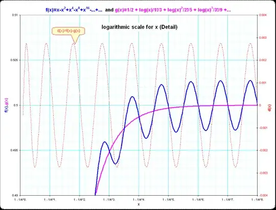

To get possibly more insight into the nature of the "wobbling" I also looked at the (naive) expansion into double-series. By writing $u=\ln(x)$ and expansion of the powers of $x$ into exponential-series we get the following table: $$ \small \begin{array} {r|rr|rrrrrrrrrrrrrr} +x & & +\exp(u) &&= +(& 1&+u&+u^2/2!&+u^3/3!&+...&) \\ -x^2 & & -\exp(2u)& &= -(& 1&+2u&+2^2u^2/2!&+2^3u^3/3!&+...&) \\ +x^4 & & +\exp(4u)& &= +(& 1&+4u&+4^2u^2/2!&+4^3u^3/3!&+...&) \\ -x^8 & & -\exp(8u)& &= -(& 1&+8u&+8^2u^2/2!&+8^3u^3/3!&+...&) \\ \vdots & & \vdots & \\ \hline f(x) & & ??? &g(x) &=( & 1/2 & +{1 \over1+2} u &+{1 \over1+2^2} {u^2 \over 2!} &+{1 \over1+2^3} {u^3 \over 3!} & +... &) \end{array}$$ where $g(x)$ is computed using the closed forms of the alternating geometric series along the columns.
The naive expectation is, that $f(x)=g(x)$ but which is not true. However, $$g(x)=\sum_{k=0}^\infty {(\ln x)^k\over (1+2^k) k! } \tag 3 $$ is still a meaningful construct: it defines somehow a monotonuous increasing "core-function" for the wobbly function $f(x)$ , perhaps so to say a functional "center of gravity".
The difference $$d(x)=f(x)-g(x) \tag 4$$ captures then perfectly the oscillatory aspect of $f(x)$. Its most interesting property is perhaps, that it seems to have perfectly constant amplitude ($a \approx 0.00274922$) . The wavelength however is variable and well described by the transformed value $x=1-4^{-y}$ as already stated by others. With this transformation the wavelength approximates $1$ very fast and very well for variable $y$.
For the generalizations $f_b(x)$ with $b \ne 2$ the amplitude increases with $b$, for instance for $b=4$ we get the amplitude $A \approx 0.068$ and for $b=2^{0.25}$ is $a \approx 3e-12$

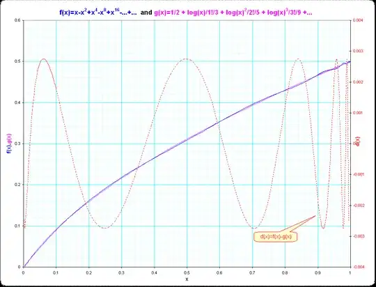

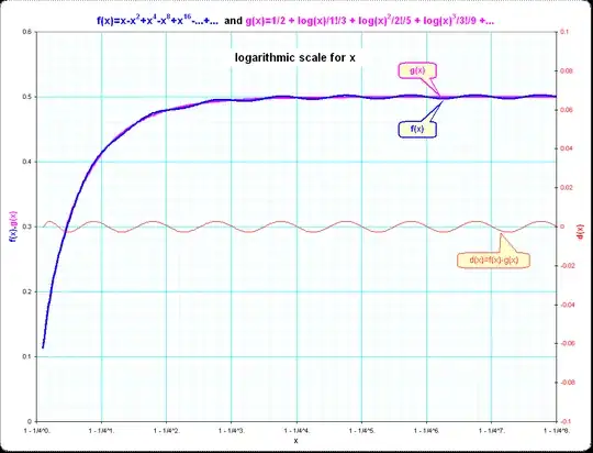

Here are pictures of the function $f(x)$, $g(x)$ and $d(x)= f(x)-g(x)$ :
The blue line and the magenta line are nicely overlaid over the whole range $0<x<1$ and the amplitude of the red error-curve (the $y$-scale is at the right side) seems to be constant.
In the next picture I rescaled also the x-axis logarithmically (I've used the hint from Robert Israel's anwer to apply the exponentials to base $4$):
Having the x-axis a logarithmic scale, the curve of the $d(x)$ looks like a perfect sine-wave (with a slight shift in wave-length). If this is true, then because $g(0)=1/2$ the non-vanishing oscillation of $f(x)$, focused in the OP, when $x \to 1$ is obvious because it's just the oscillation of the $d(x)$-curve...
For the more critical range near $y=0.5$ I've a zoomed picture for this:
But from here my expertise is exhausted and I've no tools to proceed. First thing would be to look at the Fourier-decomposition of $d(x)$ which might be simpler than that of $f(x)$. Possibly we have here something like in the Ramanujan-summation of divergent series where we have to add some integral to complete the divergent sums, but I really don't know.
