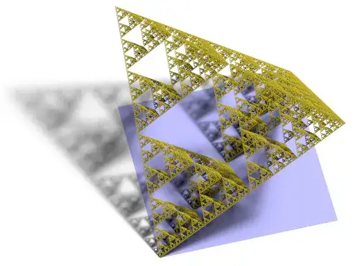

Basically, it looks like this:
3D plot of z = x xor y, producing a Sierpinski tetrahedron
(Image rendered in POV-Ray by the author, using a recursively constructed mesh, some area lights and lots of anti-aliasing.)
In the picture, the blue square on the $x$-$y$ plane represents the unit square $[0,1]^2$, and the yellow shape is the graph $z = x \oplus y$ over this square, where $\oplus$ denotes bitwise $\rm xor$.
Note that this graph is discontinuous at a dense subset of the plane. In the 3D rendering above, no attempt has been made to accurately portray the precise value of $x \oplus y$ at the points of discontinuity, and indeed, it is not generally uniquely defined. That is because the discontinuities occur at points where $x$ or $y$ is a dyadic fraction, and therefore has two possible binary expansions (e.g. $\frac12 = 0.100000\dots_2 = 0.011111\dots_2$).
As can be seen from the picture, the graph is self-similar, in the sense that the full graph over $[0,1]^2$ consists of four scaled-down and translated copies of itself. Indeed, this self-similarity is evident from the properties of the $\oplus$ operation, namely that:
  • $\displaystyle \frac x2 \oplus \frac y2 = \frac{x \oplus y}2$, and
  • $\displaystyle x \oplus \left(y \oplus \frac12\right) = \left(x \oplus \frac12\right) \oplus y = (x \oplus y) \oplus \frac12$.
The first property implies that the graph of $x \oplus y$ over the bottom left quarter $[0,1/2]^2$ of the square $[0,1]^2$ is a scaled-down copy of the full graph, while the second property implies that the graphs of $x \oplus y$ in the other quarters are identical to the first quarter, except that the lower right and upper left ones are translated up by $\frac12$.
The resulting fractal shape is also known as the Tetrix or the Sierpinski tetrahedron, and is a 3D analogue of the 2-dimensional Sierpinski triangle, which is also closely linked with the $\rm xor$ operation — one way to construct approximations of the Sierpinski triangle is to compute $2^n$ rows of Pascal's triangle using integer addition modulo $2$, which is equivalent to logical $\rm xor$.
It may be surprising to observe that this fully 3-dimensional fractal shape is indeed (at least approximately, ignoring the pesky multivaluedness issues at the discontinuities) the graph of a function in the $x$-$y$ plane. Yet, when viewed from above, each of the four sub-tetrahedra indeed precisely covers one quarter of the full unit square (and each of the 16 sub-sub-tetrahedra covers one quarter of a quarter, and so on...).

    Woah. I wouldn't have expected it to look like that. Nice answer indeed! It's notable that that the precise thing from your identities (or, equivalently, the iteration in my answer) represents that the graph equals the union of its dilation (with factor $\frac{1}2$) towards $(0,0,0)$, $(1,1,0)$, $(0,1,1)$ and $(1,0,1)$ - the Sierpinski tetrahedron being the set satisfying this (more generally, we'd get a similar looking shape for similar dilations towards any 4 points) – Milo Brandt Dec 25 '14 at 03:18
    illuminati confirmed – Creative Magic Dec 25 '14 at 05:14
  • Woah. 15char... – Navin Dec 25 '14 at 08:18
    Is that graph an actual computer rendering of XOR (as in, the computer was programmed to render the graph of XOR), or did you find out somewhere else that the graph is the Sierpinski tetrahedron and you simply rendered that? If the latter, do you have a reference? – Jack M Dec 25 '14 at 10:34
    My! Sometimes the beauty of maths can seriously make you weep, can't it? On this question my first impetus was to comment "come on, you're defining something based on fooling around in an infinite chain of binary digits. Of course it won't have a gradient or otherwise nice visual properties." ... but, yes it has... – leftaroundabout Dec 25 '14 at 11:37
  • Jack M: No, the code I used to render this did not directly use XOR, although I could have. Basically, I built it recursively, starting with a unit cube (or, in later versions, a tetrahedron inscribe in that cube, to make the shading look nicer), replacing it with four scaled and translated copies of itself, and repeating the process (7 times, I think). You can view that as iterating the recurrence $f_i(x,y)=\frac12( f_{i-1}(2x-\lfloor2x\rfloor,2y-\lfloor2y\rfloor) + (\lfloor2x\rfloor\oplus\lfloor2y\rfloor))$, whose fixed point $f(x,y)=x\oplus y$ is. – Ilmari Karonen Dec 25 '14 at 15:44
  • ...and which was already described in Meelo's answer. I believe I could've, equivalently, just iterated over a grid of $(x,y)$ points, and placed a small object at $z=x \oplus y$ to get, but the recursive version was easy to implement in POV-Ray. Alternatively, it might've been possible to use k_g's color plots as height maps (although I'm not sure how well that would've handled the discontinuities). – Ilmari Karonen Dec 25 '14 at 15:50
  • Can you post the source code for the render? I'd like to have a high-resolution version. – flaviut Dec 25 '14 at 21:20
    @user60561: Sure, here you go. The render options I used for the final render were something like +A0.01 +AM2 +R5 File_Gamma=sRGB Display_Gamma=sRGB. (For a quicker but OK render, try, say, +R2 instead of +R5.) If rendering at a high resolution, you may want to change the 7 in the #for loop to 8 or even 9. – Ilmari Karonen Dec 25 '14 at 22:08

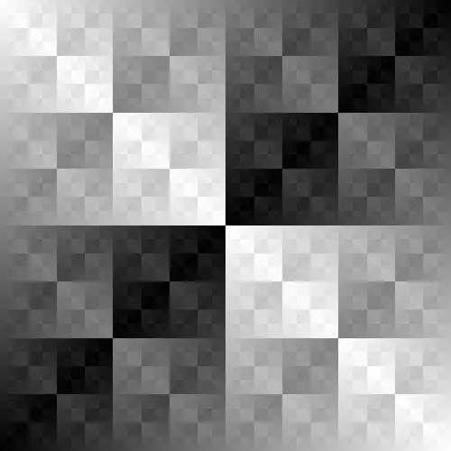

Here's what XOR looks like. Black is $z=0$; White is $z=1$. The x and y axes run from $[0,1]$.
XOR
I used the (naive) formula
$ x \oplus' y = \left(\lfloor 2^{20}x\rfloor \oplus \lfloor 2^{20}y\rfloor\right)2^{-20} $
At least with this naive interpretation, the function does not seem continuous.

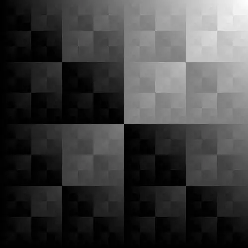

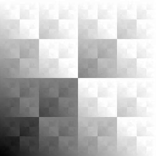

EDIT: using analogous formulas, here are
AND: enter image description here
OR: enter image description here
They all look pretty similar, but the 0:1 ratio difference is noticable.
The XOR looks like a fractal, rather than an addition plot.
