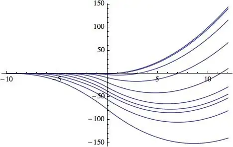

Here's a plot of $u(x,x+k)$ for $k \in \{0,1,2,\ldots,9\}$:
hardmath

  • Thanks a lot! If you can post the code you've used to plot the function it would be great! I'm trying to understand how the singularity (in the second derivative) will behave in the solution. I could Plot3D the function itself in Mathematica using NIntegrate, but couldn't plot the derivatives... – User Dec 22 '14 at 21:56
  • Here's the Mathematica code:
    sol[x_, y_] := x^2 HeavisideTheta[x] + NIntegrate[(BesselJ[1, 2 Sqrt[(y - u) (-x + u)]] (x + y - 2 u))/ Sqrt[(y - u) (-x + u)] u^2 HeavisideTheta[u], {u, x, y}];
    Plot[Table[sol[x, x + k], {k, 0, 9}], {x, -10, 12}]
    I wouldn't use Plot3D because it would be hard to appreciate the behavior of the solution. For a start, I like plotting the curves as I have. You may want to rewrite the integral in terms of $u(x,x+k)$. ContourPlot is another option.
