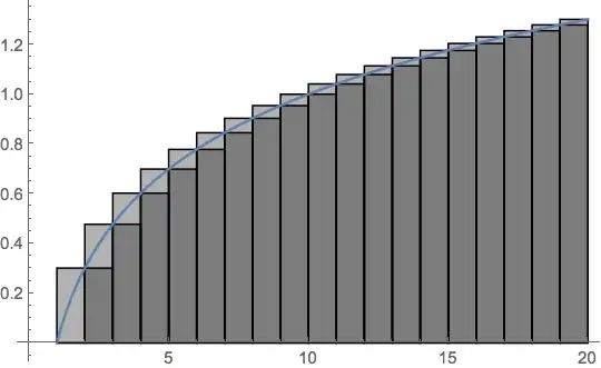

Suppose that $x$ is a positive, $n$-digit integer. Note that, $$n-1=\log_{10}(10^{n-1}) \leq \log_{10}(x) < \log_{10}(10^n) = n.$$ Thus, you might compute, the floor of $\log_{10}(100!)$ and add $1$. But \begin{align} \log_{10}(100!) &= \sum_{k=1}^{100} \log_{10}(k) \approx \int_{1}^{100}\log_{10}(t)dt \\ &= \left.\frac{t\ln(t)-t}{\ln(10)}\right|_1^{100} \approx 157.005 \end{align} Thus, the answer ought to be 158.
The reason this can be expected to work is that the integral can be approximated via Riemann sums. In fact, $$\sum_{i=1}^{n} \log_{10}(i) < \int_1^n \log_{10}(t)dt < \sum_{i=2}^n\log(10,i) = \sum_{i=1}^n\log(10,i),$$ as illustrated for $n=20$ in the following picture:
Thus, $$\sum_{i=1}^{n} \log_{10}(i) - \sum_{i=1}^n\log(10,i) < \int_1^n \log_{10}(t)dt - \sum_{i=1}^n\log(10,i) < 0.$$ But, the term on the left is just $\log_{10}(100)=2$. So, the integral is a lower bound for the sum that cannot be more than two off of the actual value. Accounting for the fact that the integral is nearly mid-way between the sums, the error should less than one, which is why we hit he answer exactly.
