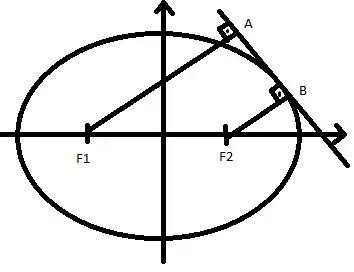

Consider the ellipse with equation: $$\frac{x^2}{a^2} + \frac{y^2}{b^2} = 1$$ How do we prove the product of distances from the foci to any tangent line is $b^2$?
$$F_1A \cdot F_2B = b^2$$

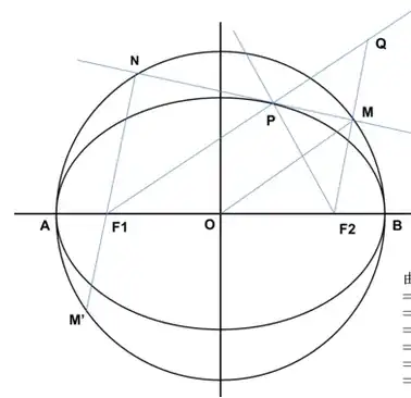

8
It is well know $$\angle QPM=\angle F_{2}PM,\Longrightarrow PQ=PF_{2},QM=F_{2}M$$ so $$OM//F_{1}Q\Longrightarrow OM=\dfrac{F_{1}Q}{2}=\dfrac{F_{1}P+F_{2}P}{2}=a$$ so $M,N\in\bigodot O$ so $F_{1}M'=F_{2}M$ so $$F_{1}N\cdot F_{2}M=F_{1}N\cdot F_{1}M'=F_{1}A\cdot F_{1}B=(a+c)(a-c)=b^2$$
