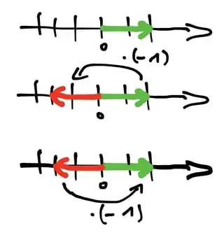

In the complex plane we have $$ -1 = e^{i\pi} $$ Multiplication by $-1$ can be interpreted as rotation by $\pi=180^\circ$. If you do this twice $(-1)(-1)$ you end up where you started $$ (-1)(-1)= e^{i\pi} e^{i\pi} = e^{i2\pi} = e^{i 0} = 1 $$ One could also argue like this without complex numbers, like this:
