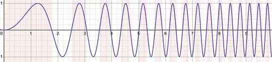

A small remark on Jon's answer that doesn't quite fit in the comments -- there is a minor technical point where one has to distinguish the sign of $S_1$ and $C_1$. I sketch out Jon's proof below:
  1. Show that $S_2,C_2 = \pi,0$
  2. Use trigonometric identities to arrive at $ \pi= S_2 = 2 S_1 C_1$ and $0 = C_2 = C_1^2 - S_1^2$, i.e. that $|C_1|=|S_1|$.
  3. From the first equation we also know that $S_1$ and $C_1$ have the same sign, and thus $S_1 = C_1 = \pm \sqrt{\pi/2}$.
The point of this answer is to finish the proof by turning the $\pm$ into $+$. It suffices to show that $\int_0^\infty \sin x^2 dx>0$ by symmetry and the above.
Let $x_k = \sqrt{k \pi}$ be the positive roots of $\sin x^2$, and put $I_k = [x_k,x_{k+1}]$. From the graph enter image description here it is clear that we will be done if we can show $$ \int_{I_k} |\sin x^2| \ dx > \int_{I_{k+1}} |\sin x^2| dx.$$ From the periodicity of $\sin$ it is natural to consider a map $T: I_k \to I_{k+1}$ that takes each point in $I_k$ to the corresponding point in $I_{k+1}$ satisfying $$ \sin T(x)^2 = \sin x^2.$$ There are generically two choices of $T(x)$ for each $x$; we can enforce uniqueness by asking for $T$ to be nice e.g. preserve order. A little back-of-the-envelope calculation yields that $ T(x) = \sqrt{\pi + x^2}$.
In the $RHS=\int_{I_{k+1}} |\sin x^2| dx$, make the change of coordinates $T(y)=x$ so that $T'(y)dy = dx$ where $T'(y) = (1+\pi/y)^{-1}$. The result now easily follows since $T'<1$: $$RHS = \int_{T(I_{k})} |\sin x^2| dx = \int_{I_{k}} |\sin T(y)^2| T'(y) dy < \int_{I_{k}} |\sin y^2| dy = LHS. $$
