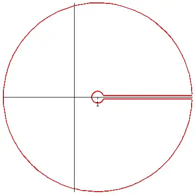

EDIT: Ah! If you transform the integral by $x = 1/t$, it becomes
$$ \int_1^\infty (t-1)^{a-1} t^{-1-n}\; dt $$
Now use $\oint_C (1-z)^{a-1} z^{-1-n}\; dz$ for a "C" contour
and note that the residue at $z=0$ is $$\dfrac{(-1)^n}{n!} \prod_{j=1}^{n} (a - j)$$

  • You have the sine term I include below in your first answer taking the form of two Gamma function terms but I am unable to locate it in your second answer? – Marko Riedel Dec 03 '14 at 04:23
  • The "sine" term comes from the difference between $(z-1)^{a-1}$ above and below the cut on $[1,\infty)$. – Robert Israel Dec 03 '14 at 04:28
  • Thanks. This is the same effect as in my answer. Now that it is in the comments your readers will know to include this factor. Nice how your substitution works with a single branch of the logarithm. I used two branches because I remember that this is what these exercises usually look for. – Marko Riedel Dec 03 '14 at 04:34
