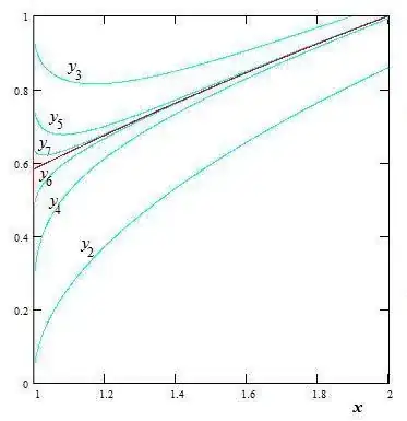

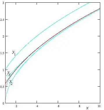

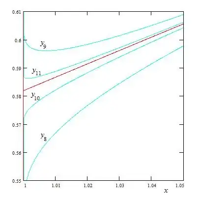

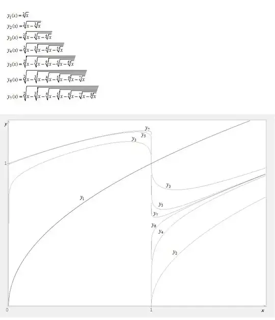

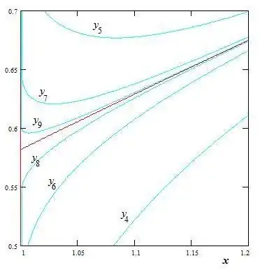

The figure below will give a new view on this question of limit or no limit. We consider an infinite set of functions $y_1(x)$ , $y_2(x)$ , ... , $y_n(x)$ , ... where the index $n$ is the number of radicals :
In case of the functions with odd index, the limit for $x$ tending to $1$ is $y(1)=1$
In case of the functions with even index, the limit for $x$ tending to $1$ is $y(1)=0$
When the number of radicals tends to infinity without specified parity, the limit is not defined. So we could say that there is no limit for the expression given in the wording of the question.
But, what is interresting is not the set of functions and corresponding curves, but what is the boundary curve of the infinite set of curves. This curve is not included into the set itself. The corresponding function might be on the form $y_{boundary}(x)=f(x)H(x-1)$ where H is the symbol of the Heaviside step function. Looking for $f(x)$ is something else: This is a challenge.

For $\epsilon=0$, this confirms that $y_n$ is alternatively equal to $0$ and to $1$ when $n$ tends to infinity.
When $n$ tends to infinity, the curves corresponding to the functions $y_n(x)$ tend asymptotically to a curve $f(x)$ for $x>1$. For $x=1$, $y_n(1)$ tends to $1$ if $n$ is odd, or tends to $0$ if $n$ is even.
The bounding curve corresponding to $f(x)$ is drawn in red on the figures below, represented in various enlargements. Of course, the curve in red is the same for all the figures. It looks like a straight line if we consider a range of $x$ close to $x=1$, but it is a misleading impression : $f(x)$ is not a linear function. The computation for drawing $f(x)$ was made with an algorithm similar to that given by Han de Bruijn.

  • What are the curves you have plotted there? I don't get the same result for $x<1$, the function is complex for odd index $>1$ there, and neither real nor imaginary part resembles what you've plotted. Looks like you've plotted something like $\sqrt x+f_i(x)$ for $x<1$ and $i>1$, $i$ odd. – Ruslan Dec 23 '14 at 14:49
  • $y_3$ is real if $x>1$ because $x>x^{1/3}>(x-x^{1/4})^{1/3}$ and $x>x^{1/4}$ if x>1. OTOH, if $x<1$ then $x-x^{1/4}<0$ so $x-(x-x^{1/4})^{1/3}>x$ and it has a real square-root, so $y_3$ is real again. – Empy2 Dec 23 '14 at 15:07
  • @Ruslan: The seven curves ploted on the figure correspond to the seven equations written on the same figure : $y_1(x)$ , $y_2(x)$ , ..., $y_7(x)$. Of course, they are ploted in real domains for $x$ and $y$. – JJacquelin Dec 23 '14 at 16:40
  • @Michael oh, indeed. Was basing my comment on Mathematica plot. It appears to take the wrong branch of cubic root, funny!.. – Ruslan Dec 23 '14 at 17:58
  • @Ruslan, if you raise a negative number to 0.33333, it has to multiply the angle $\pi$ by 0.33333 Is there an nth-root command in Mathematica? – Empy2 Dec 23 '14 at 18:54
  • @Michael yeah, there's a command, but it transforms internally to Power[x,1/3], where although 1/3 is an exact number $\frac13$ (not an approximation like $0.33333$), the principal branch is defined differently from specifically CubeRoot[] or Surd[]. I.e. you can enter $\sqrt[3]x$ via Ctrl+2$\to$x$\to$Ctrl+5$\to$3, and it'll be taken as $x^{1/3}$. Using Surd[] fixes the problem, so the plots in this answer are actually correct. – Ruslan Dec 23 '14 at 19:00

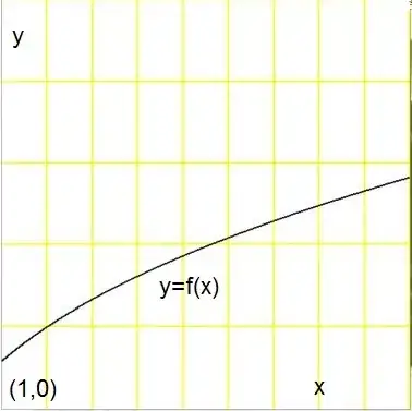

BONUS. Making a graph of the following more general function $f(x)$ might be interesting. $$ f(x) = \lim_{n\to \infty}\sqrt[2]{x-\sqrt[3]{x-\sqrt[4]{x-\cdots-\sqrt[n]{x}}}} $$ So here goes, for $\;1 < x < 10\;$ and $\;0 < y < 5\;$ :
It is conjectured that $f(2) = 1$ . Proof :
