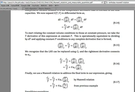

Start with
$$dS=\left(\frac{\partial S}{\partial T}\right)_VdT+\left(\frac{\partial S}{\partial V}\right)_TdV$$
Using the notes shown here
Method 1:
i) Divide both sides by dV $$\frac{dS}{dV}=\left(\frac{\partial S}{\partial T}\right)_V\frac{dT}{dV}+\left(\frac{\partial S}{\partial V}\right)_T\frac{dV}{dV}$$
ii) and at const. P
$$\left(\frac{dS}{dV}\right)_P=\left(\frac{\partial S}{\partial T}\right)_V\left(\frac{dT}{dV}\right)_P+\left(\frac{\partial S}{\partial V}\right)_T\left(\frac{dV}{dV}\right)_P$$
$$\left(\frac{dS}{dV}\right)_P=\left(\frac{\partial S}{\partial T}\right)_V\left(\frac{dT}{dV}\right)_P+\left(\frac{\partial S}{\partial V}\right)_T$$
Question 1: but how does
becomes
$$\left(\frac{\partial S}{\partial V}\right)_P=\left(\frac{\partial S}{\partial T}\right)_V\left(\frac{\partial T}{\partial V}\right)_P+\left(\frac{\partial S}{\partial V}\right)_T???$$
Method 2:
Differentiate both side wrt V, holding P const. and use product rule
$$\frac{\partial}{\partial V}\left(dS\right)_P=\frac{\partial}{\partial V}\left(\left(\frac{\partial S}{\partial T}\right)_VdT\right)_P+\frac{\partial}{\partial V}\left(\left(\frac{\partial S}{\partial V}\right)_TdV\right)_P$$
$$\left(\frac{\partial dS}{\partial V}\right)_P=\left(\left(\frac{\partial^2 S}{\partial V \partial T}\right)_V\right)_PdT+\left(\frac{\partial S}{\partial T}\right)_V\left(\frac{\partial dT}{\partial V}\right)_P+\left(\left(\frac{\partial^2 S}{\partial V^2}\right)_T\right)_PdV+\left(\frac{\partial S}{\partial V}\right)_T\left(\frac{\partial dV}{\partial V}\right)_P$$
Question 2: I got so many extra terms, and how to deal with these $$\left(\frac{\partial \text{ d blah}_1}{\partial \text{ blah}_2}\right)_{\text{blah}_3}$$ terms?
Tl:dr
How to partial differentiate a total differential rigorously?

  • So to go from $$ dS = \left( \left. \frac{\partial S}{\partial T} \right|{V} + \left. \frac{\partial S}{\partial V} \right|{T} \left. \frac{\partial V}{\partial T} \right|{P} \right) dT + \left. \frac{\partial V}{\partial P} \right|{T} dP $$
    to
    $$ \left. \frac{\partial S}{\partial T} \right|{P} = \left. \frac{\partial S}{\partial T} \right|{V} + \left. \frac{\partial S}{\partial V} \right|{T} \left. \frac{\partial V}{\partial T} \right|{P} $$
    We are not actually differentiating wrt dT keeping P constant but, just recognizing that the (.) in the (.)dT term is
    – Secret Nov 26 '14 at 09:05
  • $\left. \frac{\partial S}{\partial T} \right|_{P}$ ?
    which physicists often said as dividing by dT and let P constant is because the notations in the expression look superficially the same, but what actually happening is $\left. \frac{\partial S}{\partial T} \right|_{P}$ term is another expression that forms part of dS?
  • @Secret Yes. Once you know $dS = ()dT + ()dP$ it follows from the definition of the partial derivative that the first () contains $\left. \frac{\partial S}{\partial T} \right |_P$. The notion of "dividing by dT" is a bit misleading and unnecessary. – user_of_math Nov 26 '14 at 09:50
  • Btw, for part 2, is a total differential of a function (e.g. dS) is not a function itself (only S is), thus we never partial differentiate any d(blah) terms? – Secret Nov 26 '14 at 11:26
  • @Secret Yes, you could think of it that way. You should never have to take partial derivatives of d(whatever) by itself, only of (whatever) keeping some variable fixed. – user_of_math Nov 26 '14 at 11:33
