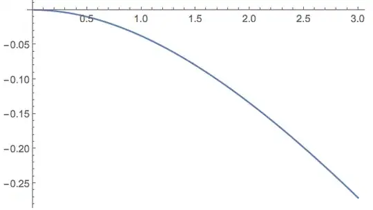

Here, we can see a plot of the difference $\ds{\sum_{n\ =\ 0}^{\infty}\expo{-x\root{n}} - \bracks{{2 \over x^{2}} + \half + {\zeta\pars{3/2} \over 4\pi}\,x}}$: enter image description here

  • (+1). Nice work. You seem to have used the Mellin transform $$\mathfrak{M}\left(\frac{1}{e^x-1}; s\right) = \int_0^\infty \frac{x^{s-1}}{e^x-1} dx = \Gamma(s)\zeta(s).$$ We use the functional equation of the Riemann Zeta function to verify that your coefficient on $x$ is the same as mine. – Marko Riedel Nov 26 '14 at 18:29
  • Can you maybe explain how you simplified the numerator in the integral at the end of the first line? I get $$e^{-x\sqrt{it}}-e^{-x\sqrt{-it}} =e^{-x\sqrt{t}(1+i)/\sqrt{2}}-e^{-x\sqrt{t}(1-i)/\sqrt{2}} = - 2i e^{-x\sqrt{t}/\sqrt{2}} \sin(x\sqrt{t}/\sqrt{2}).$$ – Marko Riedel Nov 26 '14 at 18:52
  • @MarkoRiedel It was a typo. I just fixed it. Thanks. – Felix Marin Nov 26 '14 at 21:22
  • Do you maybe want to take another look at the integral on the second line? – Marko Riedel Nov 27 '14 at 12:30
