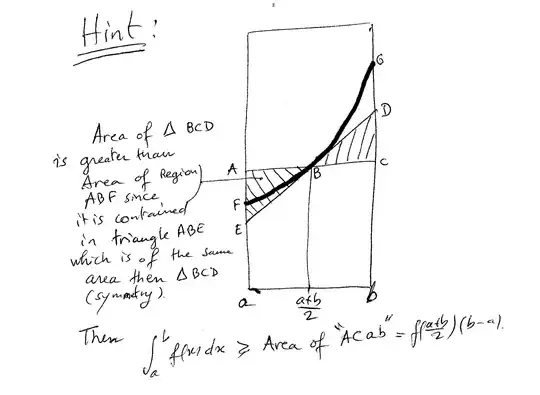

I attach a hint describing the situation
Idris Addou
  • 4,223

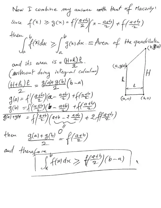

NOw i have finished the proof in the attached picture
Idris Addou
  • 4,223
