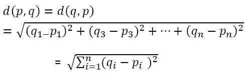

they mentioned in the paper the below formula :
The Euclidean distance between point p and q is the length of the line segment connecting them (p,q). In Cartesian coordinates, if p = (p1, p2,..., pn) and q = (q1, q2,..., qn) are two points in Euclidean n-space, then the distance from p to q, or from q to p is given by:

  • your definition you gave of distance is correct, however the examples seem to be missing a great deal of information. "The euclidean distance is ...", the euclidean distance from what to what? Average euclidean distance from P1 to the other four points? Diameter of the set of the points (iow, max distance between two of the points from the set)? None of those seem to match. Double check if it is referring to the euclidean distance of something specific, and if so what – JMoravitz Nov 21 '14 at 20:59
  • Euclidean distance from what to what? In both examples there is only one point. – Martín-Blas Pérez Pinilla Nov 21 '14 at 20:59
  • The formula is misleading because it is missing the $(q_2 - p_2)^2$ term. – Reinstate Monica Nov 21 '14 at 21:04
  • @jef a typo which was overlooked by the writer, but corrected in the generalized summation notation – JMoravitz Nov 21 '14 at 21:06

The author does not however explain what exactly he is taking the "euclidean distance of" and any and all attempts I have made at trying to figure that out have come up blank. There does not seem to be any logical explanation for how he comes up with his value for $D$. It is seemingly unrelated to mean, median, population standard deviation, sample standard deviation, third moments, distance to origin (assuming he treats all values as a combined point), total distance to origin (treating all as separate points), distance to a point (a, a+1, a+2, a+3, a+4), distance to a point (a,a,a,a,a), or others still. He also presents his value for $Q_f$ without any evidence or proof either. Honestly, it appears as though he pulled those numbers out of thin air to make the time waiting and turnaroundtimes come out nicer than the simple round robin algorithm.
He also gave no explanation for the values for the quantam times that the $SRR$ algorithm uses. According to other sources, a seemingly optimal time quantum could be calculated by the median of burst times for the processes in the ready queue, however that does not match what he uses.
Given the huge lack of detail, inconsistent formatting in certain places, apparent misuse or misunderstanding of euclidean distance, and typo in the distance formula itself, I would not trust this author or his work as it is presented and would seek other resources. If you would like a similar paper which seems better presented, this one appears to be well organized and explained: http://arxiv.org/ftp/arxiv/papers/1111/1111.5348.pdf
