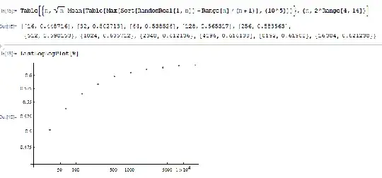

Denominators of the expectation $\mathbb{E}(V_n)$ equal to $(n+1)^{n+2}$. Exact computations of $\mathbb{E}(V_n)$ for $n$ much higher than $n=10$ is difficult due to bad complexity.
However, simulation is always at hand. enter image description here
