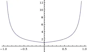

Not every smooth function induces a smooth map: $$\Phi:\mathbb{B}\to\mathbb{R}:\quad\varphi(|x|):=\frac{1}{1-|x|}$$ Just have a careful look at its diagram:
Diffeomorphic Ball
(Note that it is not even differentiable at zero!)
The problem is that the norm is not smooth in general: $$\|\cdot\|:V\to[0,\infty)$$
