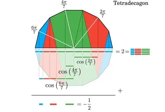

Visual proof:
polygon showing the sum
This regular 14-gon has a 'diameter' of 2. This diameter is the sum of four blue segments, four red segments and four green segments. But also each cosine can be expressed as a sum of these segments. Adding the three cosines yields the negative sum of one blue, one red and one green segment, which is $-\frac12$
Further explanation
Inside the regular Tetradecagon, the three cosines are the vertical projections of the nodes at $\{2\pi/ 7,4\pi/7,6\pi/7\}$ onto the horizontal diameter. This diameter ($\textsf{D}=2$) is further divided into twelve smaller segments, by drawing some extra lines from the other nodes at the upper semicircle, located at $\{1\pi/7,3\pi/7,5\pi/7\}$. The angle between all these (near) verticals is always the same, because all chord lengths are similar in a regular polygon. Therefore, the diameter $\textsf{D}$ consists of just three types of segments $\{\b b, \r r, \g g \}$:
$$\qquad \large \textsf{D} = \b{2b} \k + \r{2r} \k + \g{2g} \k{+} \g{2g} \k + \r{2r} \k + \b{2b} \k {= 2}$$
From which follows that:
$$\qquad \large \b{b} \k + \r{r} \k + \g{g} \k{=} \frac12$$
From the image, the sum of the three cosines can be easily expressed in these three types of segments:
$$\qquad \large \begin{align}\cos\left(\frac{2\pi}{7}\right) & = \g{2g} \k{+} \r r \\ \cos\left(\frac{4\pi}{7}\right) & = \k{-}\g g\\ \cos\left(\frac{6\pi}{7}\right) & = -\g{2g} \k{-} \r{2r} \k{-}\b b\\ \hline \\ \sum_{k=1}^3\cos\left(\frac{2k\pi}{7}\right) &= \k{-}\g g \k{-} \r{r} \k{-} \b{b} \k{=} -\frac12 \end{align}$$
$\blacksquare$

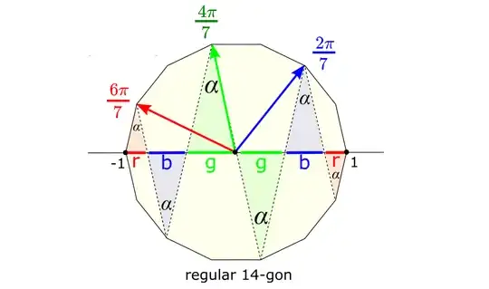

The three corresponding nodes in the unit radius tetradecagon (14-gon) can be regarded as the tops of three isosceles with top angle $\alpha = \frac{\pi}{7}$, due to the equal chords:
Summing the bases of these isosceles yields the 'radius' of the 14-gon:
$$ \color{green}{g} \color{black}{+} \color{blue}{b} \color{black}{+} \color{red}{r} \color{black}{ = 1}$$
But we also have that:
$$\begin{align}\cos\left(\color{blue}{ \frac{2\pi}{7} } \right) &= \color{green}{g}\color{black}{ \,\,\,+ \,\,\,\frac{1}{2}}\color{blue}{b} \\ \cos\left(\color{green}{\frac{4\pi}{7} } \right) &= -\frac{1}{2}\color{green}{g} \\ \cos\left(\color{red}{\frac{6\pi}{7} } \right)&= -\color{green}{g} \color{black}{\,\,\,- \,\,\,} \color{blue}{b}\color{black}{ \,\,\,- \,\,\, \frac{1}{2}}\color{red}{r} \end{align}$$
Adding these gives
$$\cos\left(\color{blue}{ \frac{2\pi}{7} } \right) + \cos\left(\color{green}{\frac{4\pi}{7} } \right) + \cos\left(\color{red}{\frac{6\pi}{7} } \right) = -\frac{1}{2}\left(\color{green}{g} \color{black}{+} \color{blue}{b} \color{black}{+} \color{red}{r}\right)= -\frac{1}{2}$$
