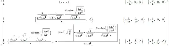

Table[Simplify[{g0[[n]], g1[[n]], g2[[n]], g3[[n]]}], {n, 2,
   4}] // MatrixForm
After running this code above we get the following result:
which matches the results given in this answer above.
