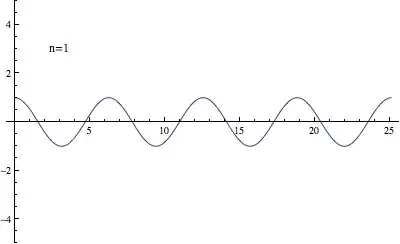

As a distribution, $$ \lim_{n\to\infty}\sqrt{n}\cos^{2n-1}(x)=\sqrt\pi\sum_{k\in\mathbb{Z}}(-1)^k\,\delta(x-k\pi)\tag{1} $$ where $\delta(x)$ is the Dirac-delta distribution.
Limit $(1)$ follows because $\cos(x)$ is $2\pi$-periodic and on any compact $K\subset[-\pi/2,3\pi/2]\setminus\{0,\pi\}$, the sequence of functions $\sqrt{n}\cos^{2n-1}(x)$ tends to $0$ monotonically for $n\ge\frac12\sup\limits_{x\in K}\cot^2(x)$. Yet, on $[-\pi/2,\pi/2]$, $\sqrt{n}\cos^{2n-1}(x)\ge0$ and using the substitution $x\mapsto x/\sqrt{n}$ $$ \begin{align} \lim_{n\to\infty}\sqrt{n}\int_{-\pi/2}^{\pi/2}\cos^{2n-1}(x)\,\mathrm{d}x &=\lim_{n\to\infty}\int_{-\sqrt{n}\pi/2}^{\sqrt{n}\pi/2}\cos^{2n-1}(x/\sqrt{n})\,\mathrm{d}x\\ &=\lim_{n\to\infty}\int_{-\sqrt{n}\pi/2}^{\sqrt{n}\pi/2}\left(1-\frac{x^2}{2n}+O\left(\frac{x^4}{n^2}\right)\right)^{2n-1}\,\mathrm{d}x\\ &=\int_{-\infty}^\infty e^{-x^2}\,\mathrm{d}x\\[9pt] &=\sqrt\pi\tag{2} \end{align} $$ Since $\cos(x+\pi)=-\cos(x)$, we get that on $[\pi/2,3\pi/2]$, $\sqrt{n}\cos^{2n-1}(x)\le0$ and $$ \lim_{n\to\infty}\sqrt{n}\int_{\pi/2}^{3\pi/2}\cos^{2n-1}(x)\,\mathrm{d}x=-\sqrt\pi\tag{3} $$
$\hspace{3.5cm}$enter image description here
