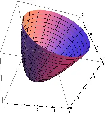

of course the standard approach to solve this easy task is to first parametrize the set with for example
$\phi(u,t)=\left(\sqrt[4]{u^2} \cos (t),\sqrt[4]{u^2} \sin (t),u\right)$
where $t \in (0,2\pi), u \in (0,2^2)$. The plot looks like: enter image description here
Generated by "ParametricPlot3D[Phi[u, t], {t, 0, 2 Pi}, {u, 0, 2^2}]" in mathematica.

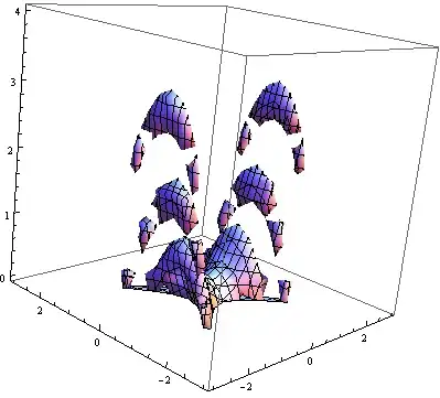

As I like to generalize solutions to such problems I try to find a possibility to input such a set in a natural form and get both of the above results, namely the plot and the surface area without doing any work by myself. However, even generating the plot seems to be very hard without parametrizing the set by hand. An approach to relax the equality a bit and use the regionplot method fails blatantly:
    RegionPlot3D[ Abs[z - x^2 + y^2] <= 0.3 && x^2 + y^2 < 4, {x, -3, 3}, {y, -3,
  3}, {z, 0, 4}]
results in the output:
And I have no idea how I would let mathematica approximate the surface of the object.

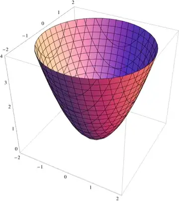

  • 14,087
ContourPlot3D[z == x^2 + y^2, {x, -2, 2}, {y, -2, 2}, {z, 0, 4}]
(source: yaroslavvb.com)
  • Nice, too bad that I didn't come up with something that simple. Is there anything one can do about the surface? – Listing Jan 24 '12 at 09:00
