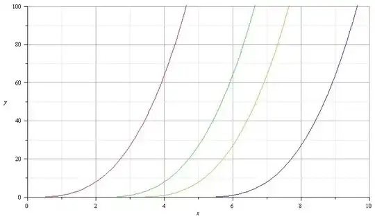

There are infinitely many solutions, of course. Indeed, all the functions of the form $$ y_s(x) = \left\{ \begin{aligned} &0 &&\text{ if } x\leq s\\ &(x-s)^3 &&\text{ if } x > s \end{aligned} \right. $$ are solutions of your Cauchy problem for any $s \geq 0$.
It is easy to check. Zero is a solution everywhere (in particular, for $x \leq s$); and $(x-s)^3$ is a solution of the Cauchy problem $$ \frac{dy}{dx} = 3 y^{2/3} \quad \text{with} \quad y(s) = 0 $$ for $x \geq s$.
Now, if we "glue" zero and $(x-s)^3$, then it will be solution of your problem, except, probably, the point $x = s$. However, at $x = s$ the function $y_s(x)$ is continuously differentiable, and hence, $y_s(x)$ is the correct solution of $$ \frac{dy}{dx} = 3 y^{2/3} \quad \text{with} \quad y(0) = 0. $$
Thus, there are infinitely many of solutions, since $s \geq 0$ is arbitrary.
