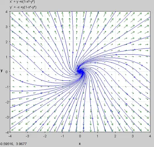

A phase portrait shows (and verifies the linearization):
Note: It is important to note that this process only works for robust cases and not for marginal cases!
