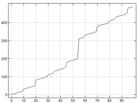

Let's look at a plot of the numbers my friend still remember:
$\hskip0.75in$enter image description here

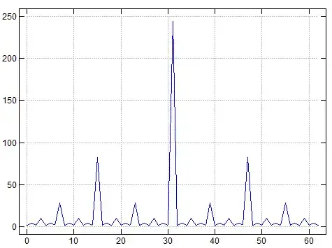

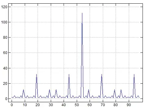

that looks like a random hops at the first glance, but take the difference between $\left(n+1\right)$th and $n$th element and you'll get this:
hence the second part of the question's title. I believe that this is a some fractal structure and therefore there exist a recurrence relation that is a solution to my problem.

I've just seen the sequence of adjacent differences from my example Base 3; digits allowed: 0, 2 that looks like this (in decimal): $$\left\{\begin{cases} 1+3^0,\quad n\equiv 2^0-1\pmod {2^1}\\ 1+3^1,\quad n\equiv 2^1-1\pmod {2^2}\\ 1+3^2,\quad n\equiv 2^2-1\pmod {2^3}\\ \cdots\\ 1+3^p,\quad n\equiv 2^p-1\pmod{2^{p+1}}\\ \cdots \end{cases} \right\}_{n\ge0}$$ In other words, if $a(n)$ is a $n$th element of the sequence, then $$a(2^{p+1} n + 2^p - 1) = 1 + 3^p, \quad p \ge 0$$ Update
Using this ideas, I conclude that $$a(n)=\sum_{i=1}^\infty\frac{1}{2^i}\sum_{j=1}^{2^i}cos(j\,n\,π/2^{i-1})$$ Thus, $$N(\{0,2\},3,n)=N(\{0,2\},3,n-1)+1+3^\wedge(\sum_{i=1}^\infty\frac{1}{2^i}\sum_{j=1}^{2^i}cos(j\,n\,π/2^{i-1}))$$ But this particular solution does not enlighten me on a general solution.
