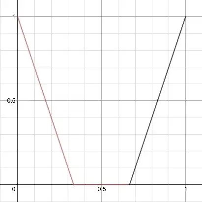

Consider this piecewise linear function as $f(x)$:
Look at this function

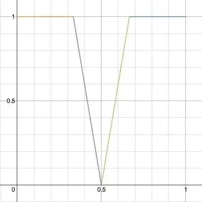

Now let $u(x)$ be the following piecewise linear function: enter image description here
Let's look at your proof with $f(x)=g(x)$. We can use the functions $s(x)=u(x)$ and $t(x)=1$ because $f(x)=u(x)f(x)$ and $f(x)=1*f(x)$.
The problem is that you can't just use any $s(x)$ and $t(x)$, you need to construct them. [Since you are only asking for a check of the proof, I won't propose a solution.]
  • Why does my interval not exist? Surely it's just (something like - I can't read the axes precisely) $(0.675,1)$? Thank you for your help so far :) – user188071 Oct 31 '14 at 21:15
  • Sorry, you're right. I misread your interval. But I still think theres a problem with the proof. Because we can make $u$ and $v$ so that $f=uf$ And $f=vf$ but neither of $u$ nor $v$ are units. – Jeremy Teitelbaum Oct 31 '14 at 21:27
  • Yes, I see the problem :) – user188071 Oct 31 '14 at 21:27
This is not true as it is shown by a simple example of Kaplansky which can be found in this answer.
