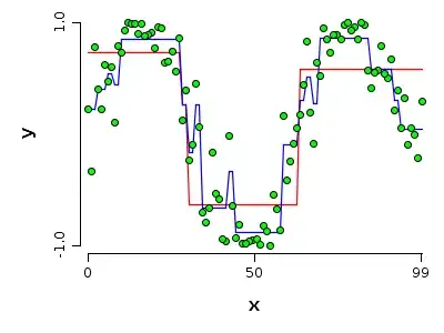

Suppose you have a training set of data which looks like a non-linear structure.
Synthetic sample with 2 regression trees. Red line is for tree with depth 3, blue line is for tree with depth 10

Considering our shallow tree we can say that the model has low variance since changing the sample does not change too much the model. It needs too many changed data points to be considered unstable. At the same time we can say that has a high bias, since it really can't represent the sine function which is the true model. We can say also that it has a low complexity. It can be described by 3 constants and 3 regions.
Consequently, the full grown tree has low bias. It is very complex since it can be described only using many regions and many constants on those regions. This is why it has low bias. The complexity of the model impacts also variance which is high. In some regions at least, a single point sampled differently can change the shape of the fitted tree.
