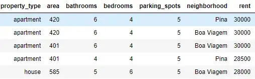

I have a dataset that has the following columns:
The variable I'm trying to predict is "rent".

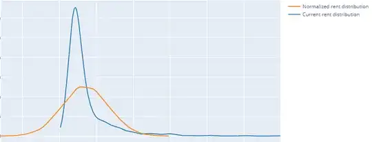

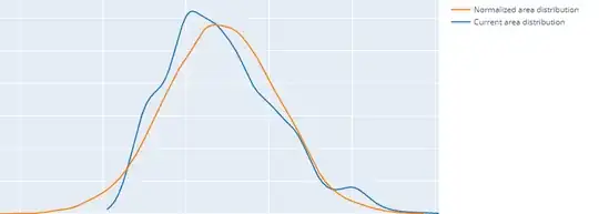

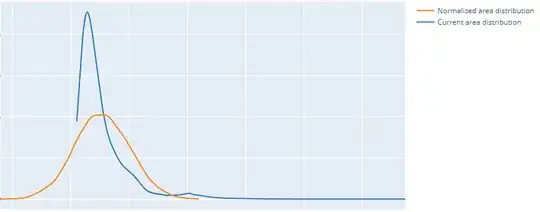

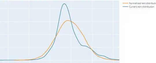

My dataset looks a lot similar to what happens in this notebook. I tried to normalize the rent column and the area column using log transformation since both columns had a positive skewness. Here's the rent column and area column distribution before and after the log transformation.
Before:
After:
I thought after these changes my regression models would improve and in fact they did, except for Linear Regression.
