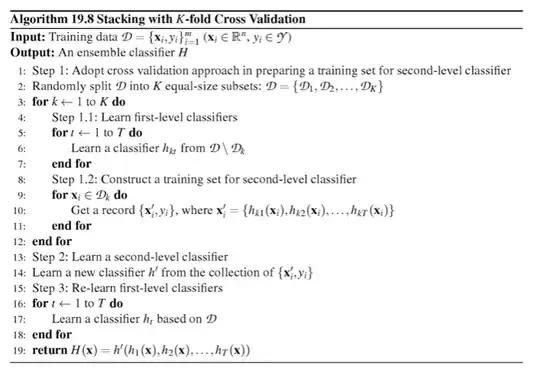

One possible solution is using a Stacking classifier as follows:
from sklearn.ensemble import StackingClassifier
# Assumed you already import  all the models you are using
dt = DecisionTreeClassifier(max_depth=DT_max_depth, random_state=0) rf = RandomForestClassifier(n_estimators=RF_n_est, random_state=0) xgb = XGBClassifier(n_estimators=XGB_n_est, random_state=0) knn = KNeighborsClassifier(n_neighbors=KNN_n_neigh) svm1 = svm.SVC(kernel='linear') svn2 = svm.SVC(kernel='rbf') lr = LogisticRegression(random_state=0,penalty = LR_n_est, solver= 'saga')
estimators = [ ('rf', rf), ('svm1', svm1), ('svn2', svn2), ('xgb', xgb), ('knn', knn), ('lr', lr), ('dt', dt) ]
Option 1:
stacker = AdaBoostClassifier()
model = StackingClassifier(
    estimators=estimators, final_estimator= stacker
Option 2:
base_model = StackingClassifier(
model = AdaBoostClassifier(base_estimator = base_model)
Option 2 will be without question the most expensive* of both and as far as I understand, option 2 fits better what you are looking for.
  • Strategy:
