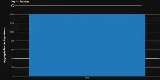

But AutoML does not seem to generate the forecast for target_value based on past values of target_value. It seems to use the date column as the independent variable! The feature importance chart also shows date as the input feature:
Feature Importance

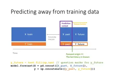

In order to perform a forecast with automl taking into consideration lagged data of the target variable you need to feed context to your forecast.
Here is the documentation: Documentation
And here is the image describing your usecase:
In the documentation, it mentions that you should feed a dataframe with historical values (with the target column filled in) and values you want to predict (with the target column empty) with the following format:
         Timestamp                               Signal
0    2022-08-07T23:00:00Z                     63.16
1    2022-08-08T00:00:00Z                     62.92
2    2022-08-08T01:00:00Z                     62.89
3    2022-08-08T02:00:00Z                     62.79
4    2022-08-08T03:00:00Z                     62.75
233  2022-08-23T17:00:00Z                       nan
234  2022-08-23T18:00:00Z                       nan
235  2022-08-23T19:00:00Z                       nan
236  2022-08-23T20:00:00Z                       nan
237  2022-08-23T21:00:00Z                       nan
