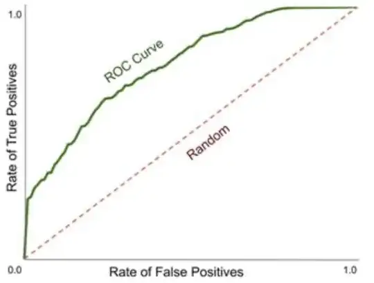

It's not clear to me how I can interpret vertical and horizontal parts of the ROC curve. What important information can I gain from this? This is a text from the book "Human-in-the-Loop Machine Learning" by Robert Monarch:
In this example, we can see that the line of the ROC curve is near-vertical for the first 20%. This tells us that for the 20% most confident predictions, we are almost 100% accurate. The ROC curve is almost horizontal at 1.0 for the final 30%. This tells us that by the time we get to the 30% least most confident predictions for a label, there are few very items with that label remaining.

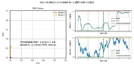

Nothing to add to @Erwan's answer, but an animated example :).
In ROC curves, each point is constructed from a threshold that defines the True Positive Rate (TPR) and the False Positive Rate (FPR). So:
  • vertical lines mean that by decreasing the thresold you only got more True Positives.
  • horizontal lines mean that by decreasing the threshold you only got more False Positives
