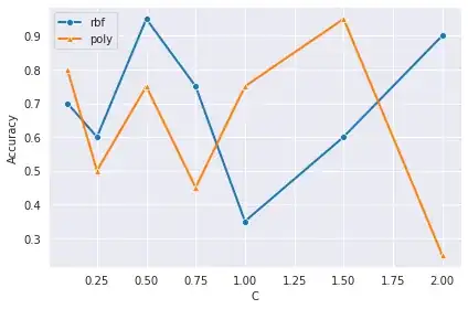

What is the best way to plot this result? in one plot that both contain the C parameter and kernel with their corresponding accuracy.

What I would suggest is to have put the results as a Data frame with
pd.DataFrame(cv.cv_results_)
And then you have the data in a dataframe which is easier to handle.
For the other question (in your comments), once you have the data in a nice dataframe is just about data visualization. How can you put it in a nice visualization?
The easier are either 2d plots or 3d or even contour plots. By googling them and python you will get nice tutorials on how to do it

You can use a simple lineplot.
