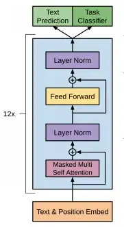

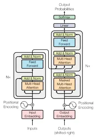

GPT uses an unmodified Transformer decoder, except that it lacks the encoder attention part. We can see this visually in the diagrams of the Transformer model and the GPT model:
transformer_diagram gpt_diagram

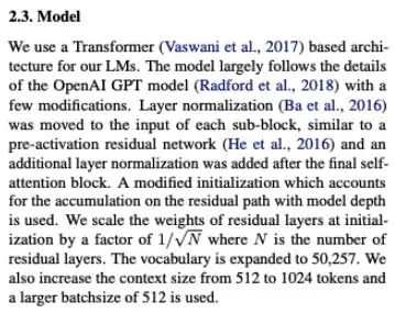

For GPT-2, this is clarified by the authors in the paper:
gpt2_section2.3
There have been several lines of research studying the effects of having the layer normalization before or after the attention. For instance the "sandwich transformer" tries to study different combinations.
