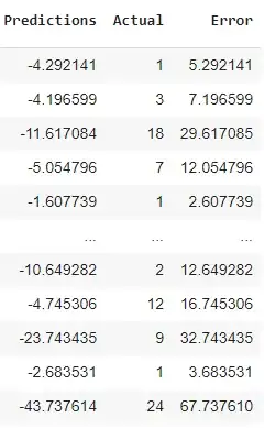

I looked at the negative predictions to understand where the model went wrong(see below image): enter image description here
It looks like if I take the absolute value of the negative predictions then that would be sufficient but is this the right method?

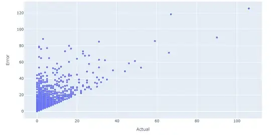

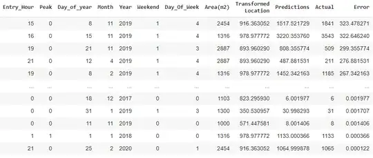

Regarding the relationship between "Actual" and "Error" column, I have plotted the graph below:
Snapshot of final results:

Gradient boosting machines can return values outside of the training range. Have a look at this post Can Boosted Trees predict below the minimum value of the training label?
In practice this is unlikely to happen, but it can be the case for your data.
If this is happening probably what it means is that your training data and the one you are evaluating are different.
