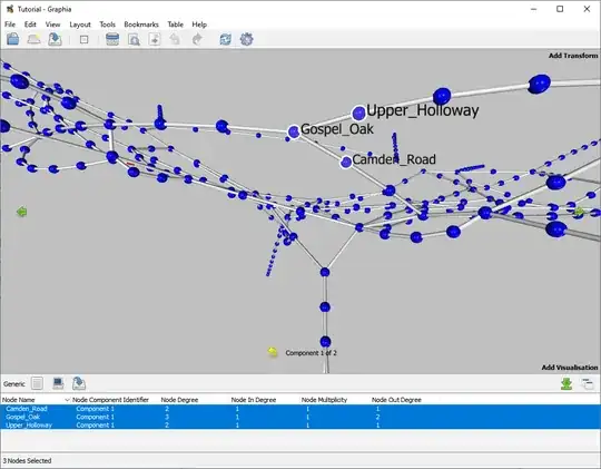

I realise this is an old question, but I thought I would point out an application that's specifically designed to interactively visualise larger graphs. This is Graphia. Disclaimer: I am involved in the development of this application. 1m nodes/50k edges is reasonably large and depending on your hardware possibly at the limit of what can be rendered, but you should have much better results with Graphia than you would with either Cytoscape or Gephi.
Graphia Main Window
