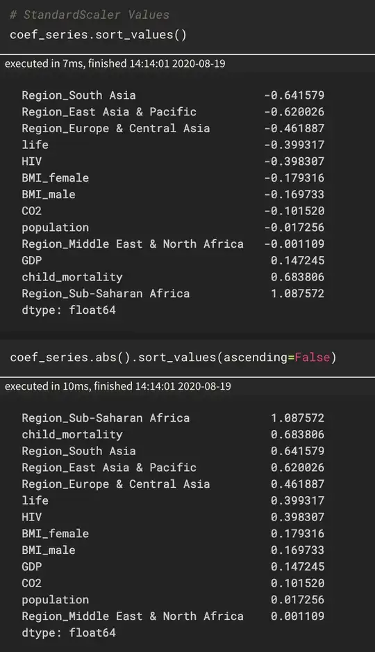

Here are two screenshots of the coefficients for two multiple linear regression models I built. It uses Gapminder 2008 data and statistics about each country to predict its fertility rate.

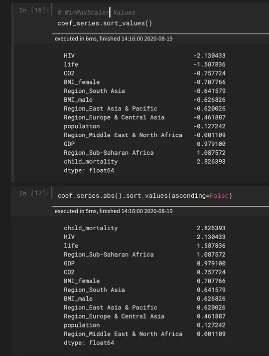

In the first, I scaled features using StandardScaler. In the second, I used MinMaxScaler. The Region_ features are categorical and were one-hot encoded and not scaled.
Not only did the coefficients change based on different scaling, but their ordering (of importance?) did too! Why is this the case? What does it mean?
Linear Model coefficients using StandardScaler for preprocessing
Linear Model coefficients using MinMaxScaler for preprocessing

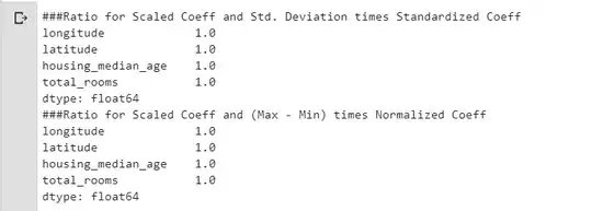

We can observe in this snippet that both the coef are in the ratio of the Standard deviation and (Max - Min) respectively w.r.t the unscaled coeff
import sys;import os;import pandas as pd, numpy as np
os.environ['KAGGLE_USERNAME'] = "10xAI"
os.environ['KAGGLE_KEY'] = "<<Your Key>>"
import kaggle !kaggle datasets download -d camnugent/california-housing-prices
dataset = pd.read_csv("/content/california-housing-prices.zip") y = dataset.pop('median_house_value') x = dataset.iloc[:,:4] from sklearn.linear_model import LinearRegression model = LinearRegression() model.fit(x,y) old_coef = model.coef_
x_s = (x-x.mean())/x.std() model.fit(x_s,y) std_coef = model.coef_
print("###Ratio of Scaled Coeff and Std. Deviation times Standardized Coeff") print(std_coef/(old_coef*x.std()))
x_n = (x-x.min())/(x.max()-x.min()) model.fit(x_n,y) nor_coef = model.coef_
print("###Ratio of Scaled Coeff and (Max - Min) times Normalized Coeff") print(nor_coef/(old_coef*(x.max()-x.min())))
So, you can calculate the unscaled Coeff from Standardized and Normalized coeff.
