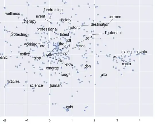

However, I cannot understand how to interpret the results. I think they are wrong and probably this is not a good approach for building a semantic network. maybe I have been missing something...For instance, this code is still keeping stopwords after the part of
words = [word for word in words if not a word in stop_words]
This is an example of output difficult to read and explain (at least, for me):
I would greatly appreciate it if you could give me some tips and advice on how to perform a semantic network that can show semantic similarity within titles.

You can try converting your word representation into a document representation by simply taking the average over the word vectors for a document. For example, if a document has 9 words with (9, 200) dimensions, by taking an average over the words you can have a document representation with a dimension (1,200).
After you have your document-representation, you can use T-SNE to find similar documents. The documents with a similar topic or theme will cluster near each other. You can always improve the document representation by improving your word vectors.
Check this
