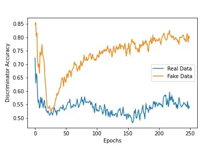

My solution here was to increase the power of the discriminator (increased the size of it) and re-train. I hoped by making it larger it would force the generator to create better samples. I got the following output.

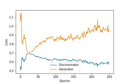

It seems that as the GAN loss increases, and is producing worse samples, the discriminator can pick it out more easily.

In theory, we should first train the discriminator to optimal. However, if it becomes too good, then it will reject fake data every time, thus making the generator unable to learn. Unlike other ML task, lower GAN losses does not mean the training is converging. Newer GANs have better techniques to make training GAN easier such as Wasserstein loss, spectral normalization and progressive growing.
