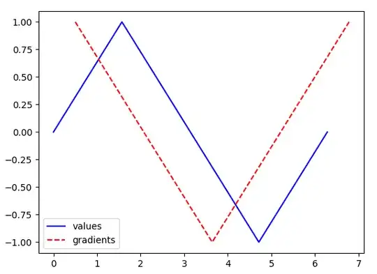

Plotting the values and the gradients - I shifted the gradients by 0.5 to the right, so their values line up with the middle of the segment for which they describe the slope:
In [7]: fig, ax = plt.subplots()
In [8]: ax.plot(x, y, "-b", label="values")                  # the y values
        ax.plot(x + 0.5, grads, "--r", label="gradients")    # the computed gradients
        plt.legend()
In [9]: plt.show()
Gradients with only 10 sample points

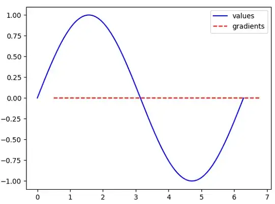

Now we do example same as before, just use one million points: N = 1_000_000. The blue line would look much more like a true sine wave, but the red line is now measuring the gradient with a much higher resolution than before, giving us the exact value at 1,000,000 points - for each tiny line segment of the blue line.
fine grained gradients
So the gradient values look like they are all zero! Well this is just because we made x2-x1 become almost zero (1 / 1e6), so the values of y2 - y1 also were essentially zero! We have started to approximate $\frac{dy}{dx}$.

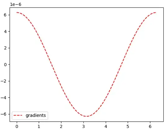

Let change the axis scale to see that the gradients do still match the pattern we might expects, and are indeed very smooth - looking like a curve:
Fine grained gradients
Much better :)
(Notice the scale difference - 1e-6).
