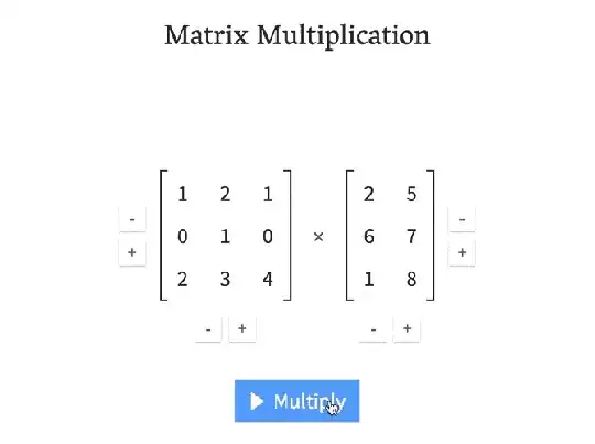

I'm looking at equations for neural networks and backpropagation and I see this symbol in the equations, ⊙. I thought matrix multiplication of neural networks always involved matrices that matched dimensions on both sides, such as... [3, 3]@[3, 2]. (This is what is happening in the animated gif).

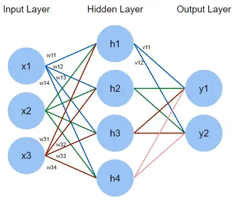

Let's look at a simple neural network with 3 input features $[x_1, x_2, x_3]$ and 2 possible output classes $[y_1, y_2]$.
Feedforward pass
In the feed-forward pass the input features will be multiplied by the weights at each layer to produce the outputs
$\begin{bmatrix} x_1&x_2&x_3 \end{bmatrix} * \begin{bmatrix} w_{1,1} & w_{1,2} & w_{1,3} & w_{1,4}\\ w_{2,1} & w_{2,2} & w_{2,3} & w_{2,4}\\ w_{3,1} & w_{3,2} & w_{3,3} & w_{3,4} \end{bmatrix} = \begin{bmatrix} h'_1 & h'_2 & h'_3 & h'_4 \end{bmatrix}$
At the hidden layer these will then go through the activation function, if we assume sigmoid then
$\begin{bmatrix} h_1 & h_2 & h_3 & h_4 \end{bmatrix} = \frac{1}{1+e^{\begin{bmatrix} -h'_1 & -h'_2 & -h'_3 & -h'_4 \end{bmatrix}}}$
Finally we go through the next set of weights to the output neurons
$\begin{bmatrix} h_1 & h_2 & h_3 & h_4 \end{bmatrix} * \begin{bmatrix} v_{1,1} & v_{1,2}\\ v_{2,1} & v_{2,2}\\ v_{3,1} & v_{3,2}\\ v_{4,1} & v_{4,2} \end{bmatrix} = \begin{bmatrix} y'_1 & y'_2 \end{bmatrix}$
$\begin{bmatrix} y_1 & y_2 \end{bmatrix} = \frac{1}{1+e^{\begin{bmatrix} -y'_1 & -y'_2 \end{bmatrix}}}$
