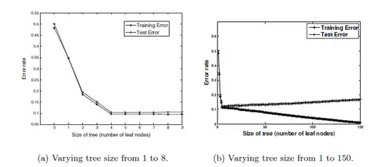

Which also brings us to Over-fitting, Regarding Over-fitting- There is this classic Error vs number of nodes graph on train and test to show how over-fitting happens in DT.
As you can see in below graph, tree with more number of nodes has lower training error but while its being tested error is higher. The gap between test and training error is telling us that the tree is over-fitting/has captured the noise when tree size is growing.
