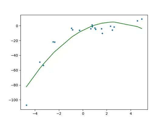

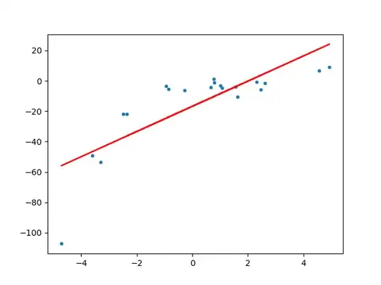

I have an understanding of simple linear regression. Clear that enter image description here results in a fitted line like this: enter image description here
However, studying polynomial regression is a bit of a challenge having some questions about the process. I understand the idea that fitting a curviliear "line" could follow the data more precisely. But seeing the following Python code in scikit-learn:

suggests for me that here we "just" projecting the original features into 2nd degree new polynomial features, while still fitting the simple (straight) line on it. Still, we get the following solution with magically curved line:
Here arise my questions:
  • How could the straight line in figure #1 become a curved one in figure #2 when we just introduce some new features but still fit the original LinearRegression model? A cannot see why couldn't the same estimator found curve in case 1 when it is able to find it in case 2? There is no hint for the estimator in the syntax in case 2 that "ok, let's apply a curve now instead of a line", right?

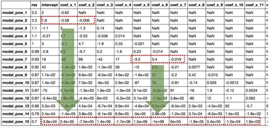

  • Additionally, having read about penalty terms for polynomial regressions, I read that the introduction of higher order features has the effect that coefficients tend to grow along the magnitude. This is illustrated here:
I cannot figure out here why does coefficients for a specific same feature (like x_1) increase just because there are more additional polynomials (e. g. x_2, x_3 etc) while stay low just being alone? Quite confusing.

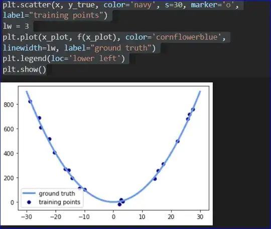

Here I go with a worked example for answering mainly your first 2 questions, with some code based on this scikit-learn example. Let's generate a rough parabola as follows:
import numpy as np
def f(x):
    """ function to approximate by polynomial interpolation"""
    return np.square(x)
# generate points used to plot
x_plot = np.linspace(-30, 30, 100)
# generate points and keep a subset of them
x = np.linspace(-30, 30, 100)
rng = np.random.RandomState(0)
rng.shuffle(x)
x = np.sort(x[:20])
y_true = f(x)
#let's include some noise so it is not a perfect parabola:
y_true = [y + np.random.randint(-30, 30, 1) for y in y_true]
y_true = np.array(y_true).reshape(len(y_true), )
We can also plot, for demonstration reasons, the regression line we expect to obtain after fitting our model on this parabola:

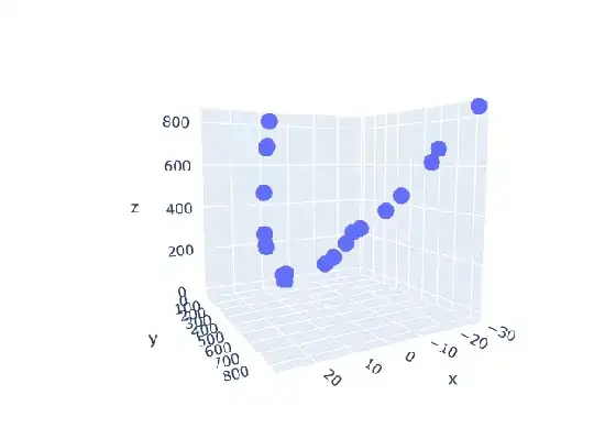

Now the question is indeed, how can we fit a linear model on this data? Let's add a higher dimensional feature (we expect degree 2 being enough):
# New input values with additional feature
import numpy as np
from sklearn.preprocessing import PolynomialFeatures
poly = PolynomialFeatures(2)
poly_transf_X = poly.fit_transform(X)

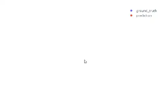

If you plot it with the amazing plotly library, you can see the new 3D dataset (with the degree-2 new feature added) as follows (sorry I named 'z' the actual y values in this animated plot):
As you can see, the f(x) values (the z component in the plot) has a parabola form regarding the x values, but a linear shape regarding the x^2 values (y-axis on this animated plot)! This is the point.

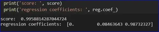

This way, we expect that if we use linear regression as our algorithm for the final model on this new dataset, the coefficient of the x^2 values feature should be nearly 1, whereas the coefficient of the x values feature (the original one) should be nearly 0, as it does not explain the shape of our ground truth y values.
from sklearn.linear_model import Ridge, LinearRegression
reg = LinearRegression().fit(poly_transf_X, y_true)
reg.predict(poly_transf_X)
score = reg.score(poly_transf_X, y_true)
And we can finally plot both the ground truth y values and the predictions, on the 3D dataset, checking that indeed a linear regression works perfectly by adding the x^2 values feature (here I finally named the y-axis for the y values :) ):

  3. One cannot say the coeficient will increase in any case, it depends on the data you have and on your model. If you want to avoid having huge differences between the values in Theta, you should apply normalization to your training and test dataset.
