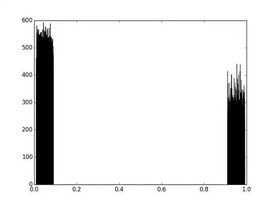

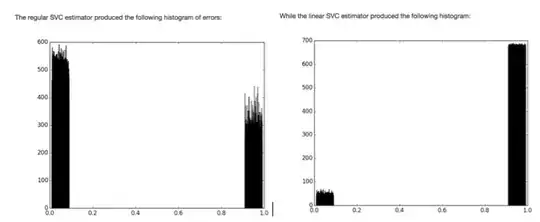

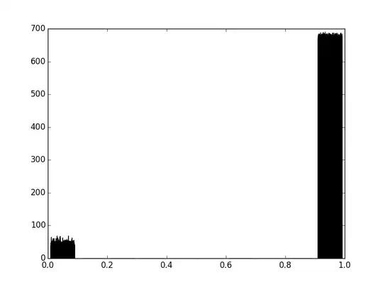

The regular SVC estimator produced the following histogram of errors: SVC Error Rate While the linear SVC estimator produced the following histogram: Linear SVC Error Rate
What could account for such a stark difference? Why does the linear model have such higher accuracy most of the time?
And, relatedly, what could be causing the stark polarization in the results? Either an accuracy close to 1 or an accuracy close to 0, nothing in between.
For comparison, a decision tree classification produced a much more normally distributed error rate with an accuracy of around .85.

A regular SVM with default values uses a radial basis function as the SVM kernel. This is basically a Gaussian kernel aka bell-curve. Meaning that the no man's land between different classes is created with a Gaussian function. The linear-SVM uses a linear kernel for the basis function, so you can think of this as a ^ shaped function. It is much less tunable and is basically just a linear interpolation.

Now take a look at your plots: enter image description here
The nonlinear basis function has higher variance. See how it is noisier than the linear kernel! The linear kernel has lower variance. See how it is less noisy!
Now lets assess bias -
Which kernel is more accurate? We can add the errors that you provided. The nonlinear kernel has a total error of ~550+325=~875. The linear kernel has an error of ~690+~50=~740. So the linear kernel seems to do better overall, but they are pretty close overall. This is were things get tricky!
Putting it all together
See how the linear kernel did a poor job on 1's and a really great job on 0's. This is pretty unbalanced. Where as the nonlinear kernel is more balanced. It kind of seems like the sweet spot might be to create a balanced model that doesn't have such high variance. How do we control for high variance? Bingo - regularization. We can add regularization to the nonlinear model and we will probably see much better results. This is the C parameter in scikit learn SVMs, which you will want to increase from the default. We could also play with the gamma parameter. Gamma controlls the width of the Gaussian. Maybe try increasing that one slightly to get less noisy results e.g. a larger no-man's land between classes.
