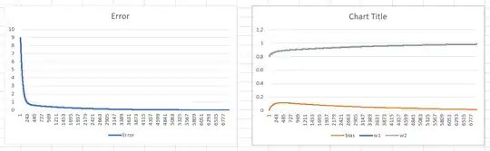

I don't have a test dataset yet, as first I'd like to overfit to a training set, to see if it could even do that. Withouot bias the training converges to an optimum in about ~4k epochs.
When I include the tuning of bias into the training, it seems to have a much worse performance, the network is not converging to the optimum, instead the biases and the weights oscillate next to one another..
Is this a normal effect of introducing a bias?
Here is a chart abuot the weight values throughout the training: enter image description here

It should not decrease performance that badly (as shown in the question). Biases help in generalizing and learning it adds complexity to the training, but it doesn't add much in this example.
Here the problem was with the implementation. After ~weeks of drooling above it, I finally got to the point where I started to use ancient methods ( pen + paper ) to verify the gradients, and therein I found a bug in the cost function:
some network outputs were compared to the wrong label values, hence the gradient calculation was faulty.
After the bug was fixed the network now converges as it should:
