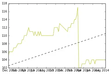

I have a linearly increasing time series dataset of a sensor, with value ranges between 50 and 150. I've implemented a Simple Linear Regression algorithm to fit a regression line on such data, and I'm predicting the date when the series would reach 120.

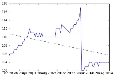

All works fine when the series move upwards. But, there are cases in which the sensor reaches around 110 or 115, and it is reset; in such cases the values would start over again at, say, 50 or 60.
This is where I start facing issues with the regression line, as it starts moving downwards, and it starts predicting old date. I think I should be considering only the subset of data from where it was previously reset. However, I'm trying to understand if there are any algorithms available that consider this case.
I'm new to data science, would appreciate any pointers to move further.

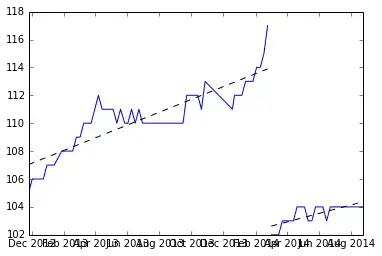

Edit: nfmcclure's suggestions applied
Before applying the suggestions
Below is the snapshot of what I've got after splitting the dataset where the reset occurs, and the slope of two set.
finding the mean of the two slopes and drawing the line from the mean.
Is this OK?

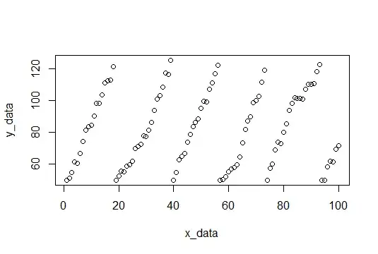

I thought this was an interesting problem, so I wrote a sample data set and a linear slope estimator in R. I hope it helps you with your problem. I'm going to make some assumptions, the biggest is that you want to estimate a constant slope, given by some segments in your data. Another assumption to separate the blocks of linear data is that the natural 'reset' will be found by comparing consecutive differences and finding ones that are X-standard deviations below the mean. (I chose 4 sd's, but this can be changed)
Here is a plot of the data, and the code to generating it is at the bottom. Sample Data
For starters, we find the breaks and fit each set of y-values and record the slopes.

Edit: Creating The Sample Data
The sample data will consist of 100 points, random noise with a slope of 4 (Hopefully we will estimate this). When the y-values reach a cutoff, they reset to 50. The cutoff is randomly chosen between 115 and 120 for each reset. Here is the R code to create the data set.
# Create Sample Data
set.seed(1001)
x_data = 1:100 # x-data
y_data = rep(0,length(x_data)) # Initialize y-data
y_data[1] = 50
reset_level = sample(115:120,1) # Select initial cutoff
for (i in x_data[-1]){ # Loop through rest of x-data
  if(y_data[i-1]>reset_level){ # check if y-value is above cutoff
    y_data[i] = 50             # Reset if it is and
    reset_level = sample(115:120,1) # rechoose cutoff
  }else {
    y_data[i] = y_data[i-1] + 4 + (10*runif(1)-5) # Or just increment y with random noise
plot(x_data,y_data) # Plot data
