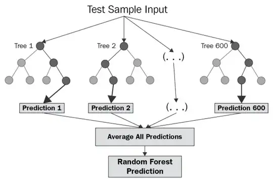

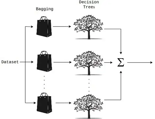

After giving much consideration, let's review the mechanism of Random Forest Regression (RFR):
So this idea or process of averaging models is a technique called Ensembling. Additionally, Random forest is a Supervised Learning algorithm which uses an ensemble learning method for classification and regression. Random forest is a bagging technique and not a boosting technique. It uses a multitude of decision trees at training time and outputting the class that is the mode of the classes (classification) or mean prediction (regression) of the individual trees. img
