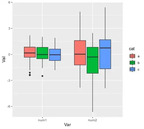

Now I want to draw a combined plot with ggplot where I (box)plot certain numerical columns (num_col_2, num_col_2) with boxplot groups according cat_col_1 factor levels per numerical columns. Along y axis is the spread of the respective selected columns (not other column). So far I couldn' solve this combined task.

If I understand right your question, you are looking to plot selected numerical columns against a selected categorical column of your dataset, am I right ?
If so, you can have the use of dplyr, tidyr and ggplot2 packages to achieve this.

Basically, you are selecting first your columns of interest (here num1, num2 and cat), then, you reshape data into a longer format using pivot_longer function to obtain something like that:
library(tidyr)
library(dplyr)
df %>% select(id, num1, num2, cat) %>%
  pivot_longer(., cols = c(num1,num2), names_to = "Var", values_to = "Val")

Finally, you can add to this pipe sequence the plotting part by calling ggplot and geom_boxplot :
library(tidyr)
library(dplyr)
library(ggplot2)
  pivot_longer(., cols = c(num1,num2), names_to = "Var", values_to = "Val") %>%
  ggplot(aes(x = Var, y = Val, fill = cat)) +
  geom_boxplot()
Is it what you are looking for ?
