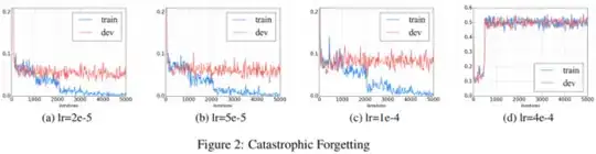

How to Fine-Tune BERT for Text Classification? pointed out the learning rate is the key to avoid Catastrophic Forgetting where the pre-trained knowledge is erased during learning of new knowledge.
We find that a lower learning rate, such as 2e-5, is necessary to make BERT overcome the catastrophic forgetting problem. With an aggressive learn rate of 4e-4, the training set fails to converge.
Probably this is the reason why the BERT paper used 5e-5, 4e-5, 3e-5, and 2e-5 for fine-tuning.
